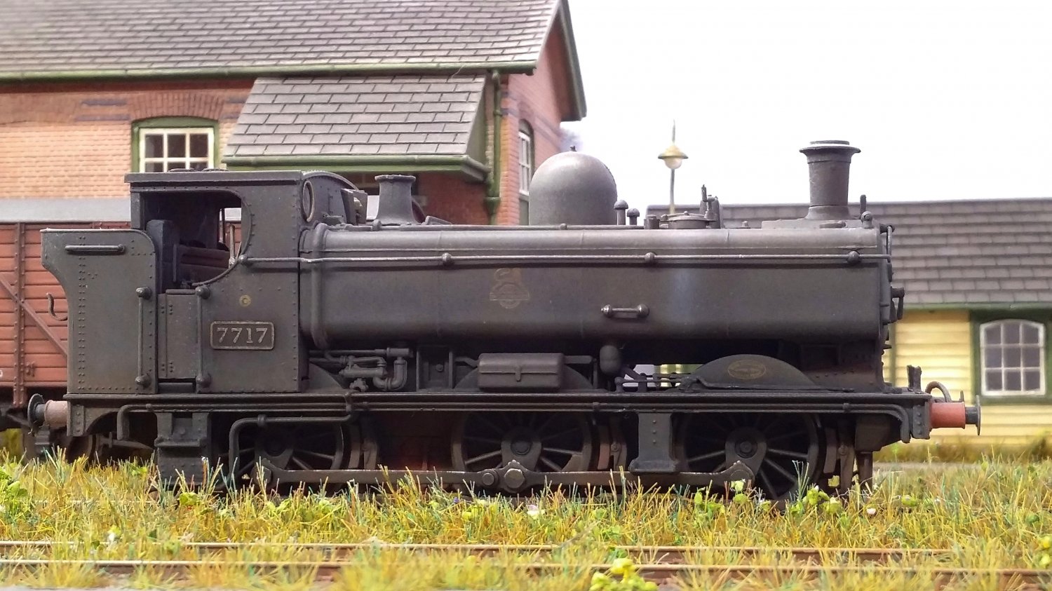

Here then is 7717, a Bachmann 57xx sent to me by Grahame in a typical act of generosity and which will be running at Stafford.
