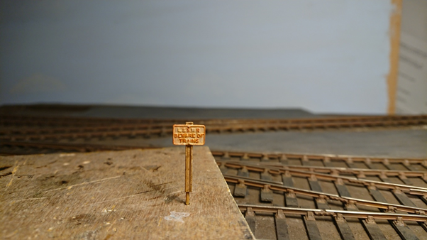

In between painting rails, I’ve been working on one or two sub-projects such as this sign.
It consists of an etch from MSE (Wizard models) soldered to a length of rail with 0.3mm wire to represent bolts. Characteristically, the SR has made use of their predecessor’s signage by repainting to obscure the L,& and W characters. In such a sleepy backwater as this, nearing the end of its days, nobody has considered a BR replacement.

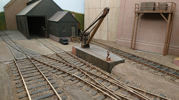

Having reached this significant milestone, I couldn’t resist setting the layout up with buildings and the various additions I’ve been working on for a few pictures.
These pictures have proved useful in setting out a (long) list of improvements and further tasks. Near the top of the list is vegetation so work has started on learning to use static grass. First attempts were promising but not worthy of recording in these pages. Look out for updates soon!.

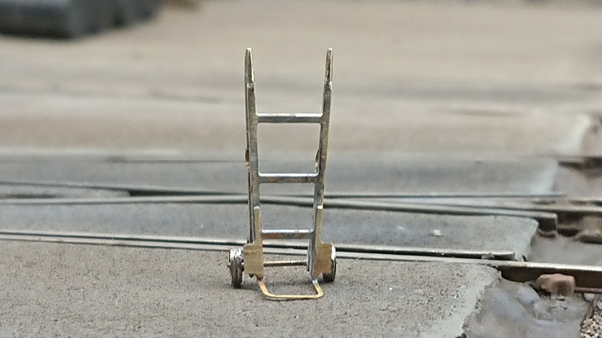

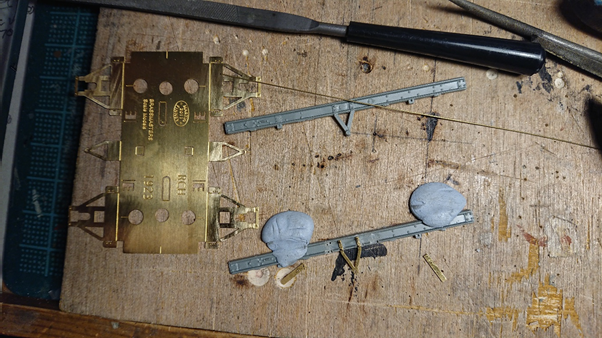

Not a lot of progress has been made recently, but I am working on a number of small detail projects, which can be fitted in to short bursts of free time. One such is this platform luggage trolley. It is a LSWR type constructed from a Southwark Bridge models kit from Roxey Mouldings. It seemed reasonable that such an item might be found lying around at Marchford Creek in my chosen timeframe.
The kit contains etches to make two trolleys. The etching is very sharp which is essential with parts so small. In all, 15 components go together to make up the unit. The wheels consist of three layers soldered together and the blocks supporting the axle are each laminated from two parts. These can be tinned on the fret and then jigged on a suitably sized lightly oiled wire. Other parts were carefully tinned before being jigged on thick card using dressmakers’ pins for location. It is fortunate that some spares are included on the fret as a couple of bits pinged off into the distance before they could be secured!
Altogether, a very fiddly but rewarding kit.

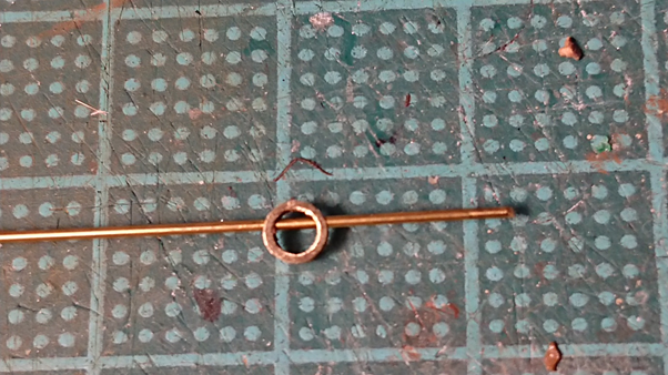

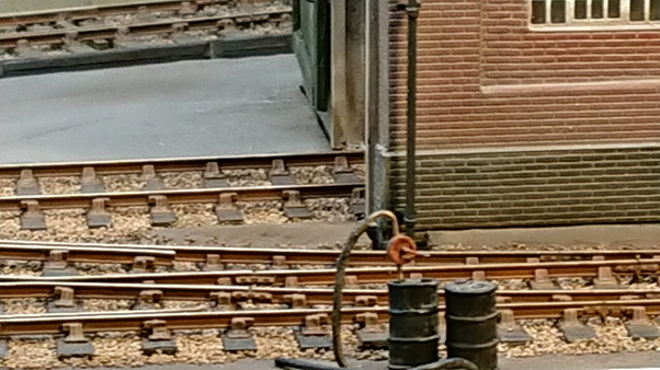

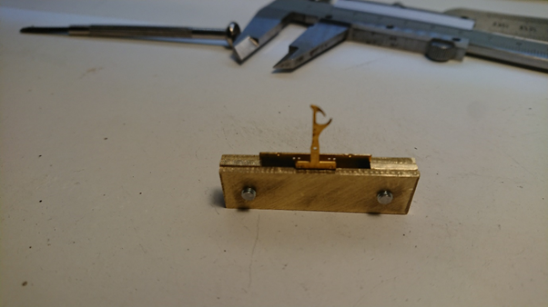

I settled on the idea that diesel loco refuelling would be accomplished using a hand operated rotary pump to transfer fuel from 45 Gallon steel drums. After consulting some information on the pumps, I had an idea how to scratch build one.
First, I cut a piece of 3.2mm o/d brass tube for the pump body and drilled an off-centre hole to take 0.8mm brass wire for the vertical tube and the outlet.
Next, some 0.4mm wire was bent to shape to form the operating handle, leaving the spindle over length. The pump body and tube assembly was taped to a well-used offcut of ply. A 0.4mm hole was drilled in the ply at the centre of the pump body to receive the over-length spindle.
The centre section was filled with solder to complete construction.
After shaping and trimming the pipes and removing the excess spindle length, the unit was complete.
Pump body and handle were painted a red oxide shade and the tube was finished with some Railmatch oily steel somewhat dirtied. The smallest size of heat shrink tube I could find in my stock was pressed into service for a hose. Some thin brass wire was inserted before shrinking to facilitate bending the finished hose to shape.
When deployed on a Ratio plastic drum, the pump unit looked much too large. A quick measure showed the drum to be significantly under scale for a standard 45 Gal unit, which should scale at 12.3mm high and 7.5mm diameter in 4mm scale.
These steel drums were, and still are, manufactured in a variety of sizes so there is nothing necessarily wrong with the kit offering. I will need to source or make suitably sized models for the 45 Gal version.

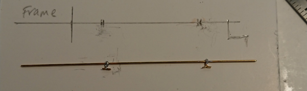

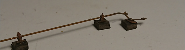

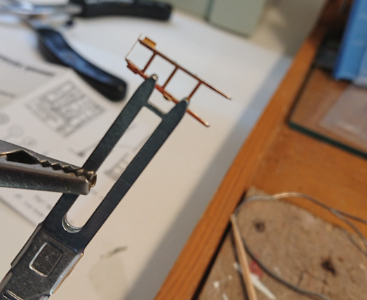

A review of etched 4mm scale products available led to the purchase of LSWR rodding stools and cranks by Southwark Bridge Models from Roxey Mouldings. The rodding itself is 0.4mm brass wire. Fortunately, Marchford Creek is a location where only one turnout requires rodding and there is only a very short run from the ground frame. A length of rodding with two stools and a crank is all that is required.
The etches are very fine and the individual parts for the stools are almost invisible!
Construction in progress – this must be one of the simplest rodding installations ever!
The complete assembly.
Here compared with the Wills offering. The plastic version is a little chunky to say the least.
And after painting, ready for installation. The stools and crank have been mounted on small wooden blocks to bring them to the correct height.
On the layout together with the completed lever frame. At this point just posed in position. There is a great deal more scenic development to be done. I was very tempted to fit a facing point lock but decided that could not possibly be justified at a goods only location. The second lever on the frame is therefore spare and painted white. The history now suggests that it was once used to operate a gate-release mechanism, of which more anon.

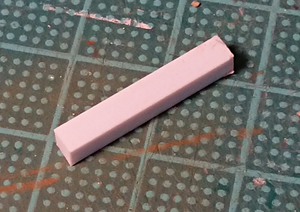

For my next task, attention turned to a gate post. The history of Marchford Creek suggests that the rail entrance to the yard was once protected by a gate, released from the adjacent lever frame to allow workings from the “main line” to enter and leave. The gate itself and one of the posts have long since disappeared but the other post remains intact after many years of disuse.
The material chosen for the post is 3.2mm square section styrene, scaling to about 9½ inches in 4mm scale, a reasonable size for a gate of this size.
Inspiration: two old farm gateposts on a regular walking route near home. One is round in section and the other square.
Styrene cut to size.
The surface was distressed using a triangular scraper and wire brush to produce a gnarly, open grain, old timber look. After painting black and dry brushing with light grey, this shows up quite well.

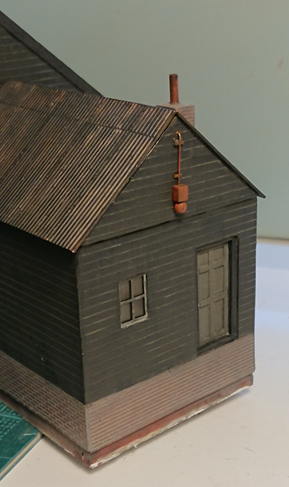

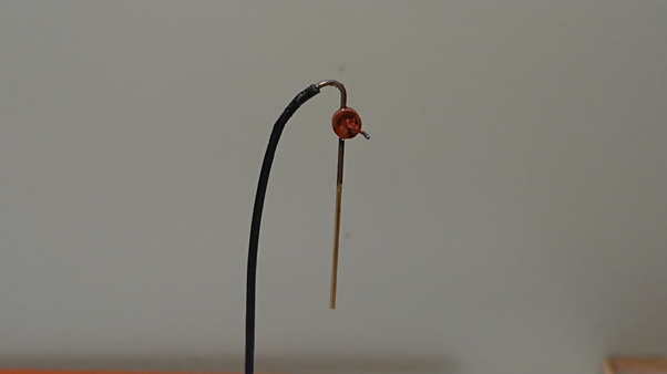

The Marchford Creek site is home to many flammable, explosive and toxic chemicals. Even in the more laid-back era portrayed in the model, long before formalised safety and regulatory systems became the norm, an emergency alarm system would be high on the list of essentials.
The only outward sign of the alarm system is an electric bell mounted on the outside wall of the foreman’s office. This may well have a secondary use as a repeater for the office telephone. The bell is of suitable stature to give an audible warning of impending doom right across the yard area.
A bit of gentle internet research gave some background on rough dimensions and designs before modelling commenced.
Two methods of construction were considered; styrene (quick and easy) or brass (less quick, less easy but more robust). I may have neglected to mention that last Christmas, I came by a small Proxxon milling machine. The choice of brass construction for my bell gave a good excuse to give it some more work.
3mm square brass was used as the basis of the model. This was milled out to form the basic shape of the frame and the housing. The housing was reduced in height and shaped to give a more pleasing look.
The bell itself was formed by filing down some 3mm diameter brass rod in the drill to give the required curvature, sawing off the resulting dome and soldering it to the base. A 0.4mm hole was drilled in the frame and a piece of wire soldered in and bent to shape to form the clapper.
Some more 0.4mm wire was bent to shape to represent the conduit and two small brackets formed from NS strip and soldered on.
Finally, the unit was painted in a suitable shade of red and weathered using enamels before fitting to the building wall.

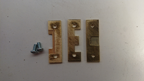

The final issue was with one of the turnout operating mechanisms. The mech in question had been working fine but after a period of time, was not providing sufficient throw to move the blades completely. This particular unit operates differently from the others on the layout in that drive is provided to one end of an extended tie bar rather than to the centre point. This method of working was adopted to enable mounting of the point motor in a sensible place. With all the design work that was carried out in advance of building, I should have spotted the error. it was found that a few bits of loose material had got into the limited space around the moving parts. Once this was cleared out and a slightly thicker operating wire substituted in the Tortoise motor, everything worked well again.

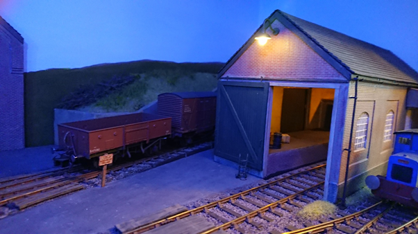

Vegetation has finally made an appearance at Marchford Creek after months of avoidance. For the most part everything has gone well in this endeavour. I have used various lengths and shades of static grass together with ground foam, rubberised horsehair and scatters. The techniques used came from Gordon Gravett’s excellent book and other published sources.
A few minor bits and pieces of development work have been completed. In order to enhance the night mode lighting, connectors have been fitted to the buildings which are fitted with lights. These make it easy to disconnect the power supply when removing buildings from the layout. The units used are from the Molex kk254 series, which can be had from a number of electronics suppliers. The transfer sheds have been fitted with exterior lights sourced from Layouts-4-u. I had intended to scratch build this but struggled to form a convincing shape for the shade. In line variable resistors have been added to these installations to allow adjustment of light intensity.

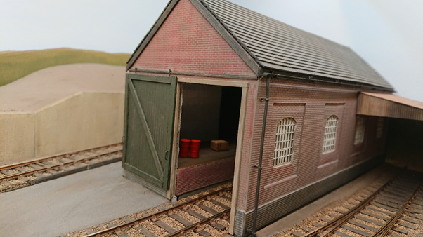

The shed has also gained a drain cover at the base of the downpipe. This was formed from a Wizard Models etch.

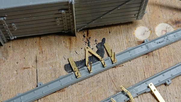

My first sprung wagon is almost complete! The underframe (Rumney Models) glides silkily through my indifferent point work despite not yet being weighted to the required 50g. The body and container (Parkside) are painted and all the parts for fixing the two together are to hand. These comprise shackles, chain links and some spring units to be formed from fine brass tube. Paul Bartlett’s online wagon resource was invaluable for getting an understanding of the details for this.
Two other wagon kits are in build using different springing units for comparison. More on this will follow.

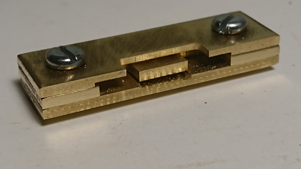

A long-planned project to make a new version of my Sprat and Winkle coupling jig has been completed. While the MK1 version (previously described in these pages) performed adequately, it was rather crude in its construction. Acquisition of my Proxxon mini mill last year meant I could construct a more sophisticated replacement. This is s useful bit of kit for consistent assembly of couplers.

Finally, here are a few images showing the layout as it currently stands. There is still a great deal to do on scenic development but the presence of some grass and a few weeds and bushes has made a big difference.

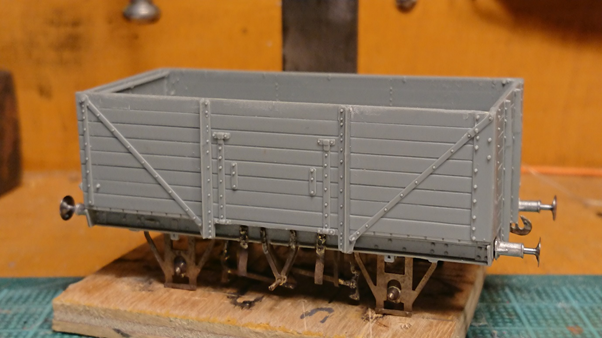

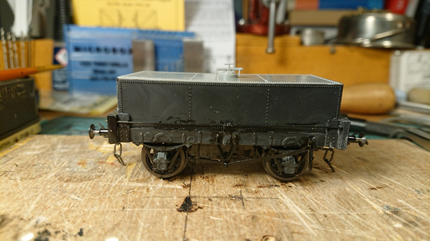

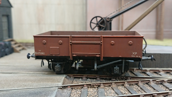

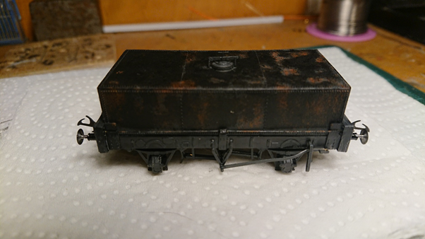

Prior to my recent lull, some progress was made on a couple of wagons for Marchford Creek. The first, a rectangular tank, has long been a favourite type of mine. It is based on a slaters kit with etched brass sprung underframe and Lanarkshire buffers fitted with sprung steel heads. I have always liked Slaters kits. The mouldings are fine and very sharp and the grade of plastic used seems less – well, plasticky than others. The tank’s function on the layout is for transport of liquids to facilitate the various processes carried out around the extensive Marchford site. One advantage of having a secretive back story is that there is no need to come up with a watertight explanation for everything. It is not based on any particular prototype but is a plausible possibility for an ancient wagon getting close to the end of its long life.
The rectank is currently going through the paint shops receiving a well-worn, rusted and chemical damaged black livery. This has been applied, so far to the tank only, using a stippling process intended to resemble a poor quality surface that has been painted over many times as the old paint flakes off. This has turned out well as far as it goes. The next stage is to tackle the wooden underframe and the chassis before adding some evidence of repeated spillage and overflows.
The other subject is a Cambrian based ex SR 8 plank open. Again, this features a sprung brass underframe and Lanarkshire buffers. The finish for this has not been decided yet.
